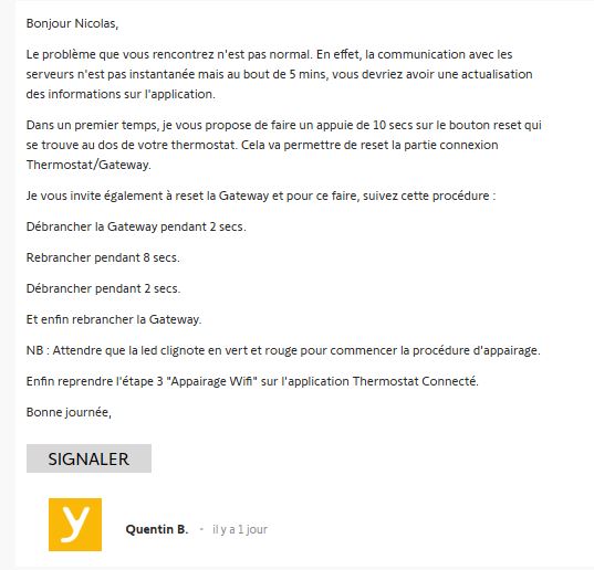

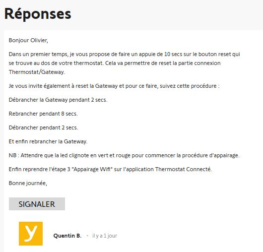

  <enclosure length="37243" url="https://dimelo-answers-production.s3.eu-west-1.amazonaws.com/177/7edcaa80a9536e64/somfy_reinit_passerelle_original.jpg?bb28c87" type="image/jpeg" />
<enclosure length="42854" url="https://dimelo-answers-production.s3.eu-west-1.amazonaws.com/177/4df937897a9e9417/somfy_reinit_thermostat_passerelle_original.jpg?bb28c87" type="image/jpeg" />
