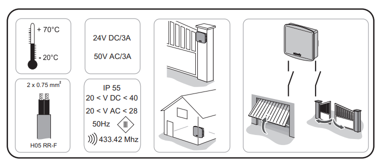

          &lt;div class=&quot;body-bd&quot;&gt;&lt;p&gt;Bonjour Rémy&lt;/p&gt;&lt;p&gt;Voici un extrait de la documentation.&lt;/p&gt;&lt;/div&gt;

  <enclosure length="54245" url="https://dimelo-answers-production.s3.eu-west-1.amazonaws.com/177/f8cdf83997334493/image_original.png?c6832e6" type="image/png" />
