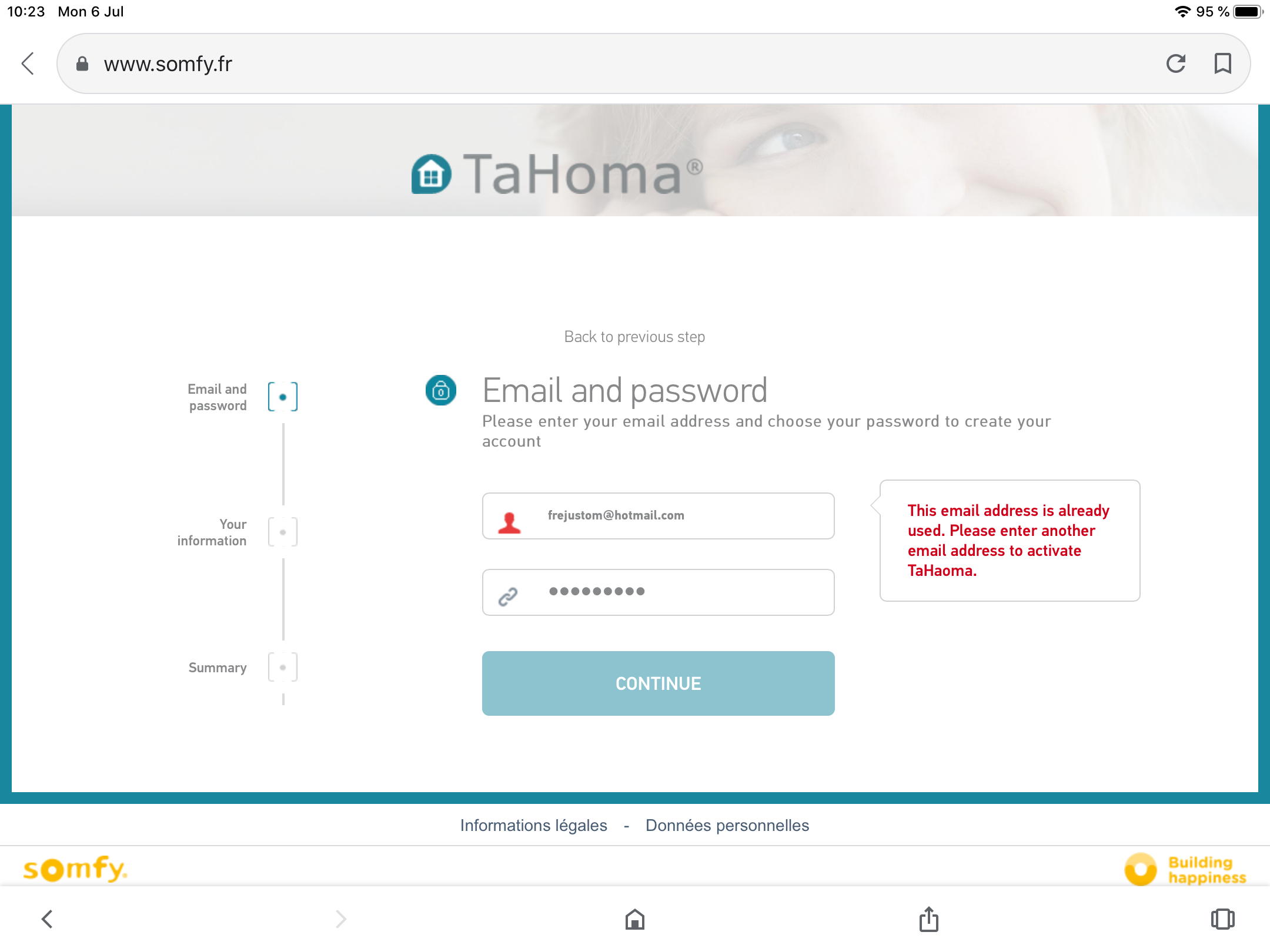

    Hi Thomas, it did not worked for the same problem and I share a photo of the problem

    Tom,
    Do you try to activate your TaHoma on the French server ? Cause this email is knwon on French server and if you try on an other server it will not work.
    Regards,

    Hi Thomas, it is the same problem on either server
    ,com or .fr
    Here is the .fr attachment saying the same

    Good Afternoon Tom,
    Where this Tahoma is installed ? In France or in an other country ?

    Installed in France, FRÉJUS. With Orange.fr
    When I try and register it with the fr server with the pin. It tells me my email address is already taken.
    Perhaps you need to delete me completely and I start again.

    Good Morning Tom,
    I have deleted your account, can you try to activate your TaHoma ?

    Hi Thomas
    We are working and many thanks for your support
